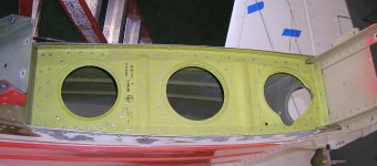

In 2004 we discovered the attached crack. Very surprised to find it where it was.
Repair attached.
