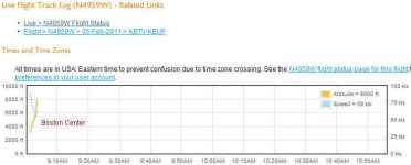

Martine and I had a great time hosting Lonnie here last eve in Vermont and watching him blast off this morning. He'll be skirting the weather to the NW and be driving into some headwinds so it won't be quite like his trip up to ISP a few weeks ago at 240 GS.
The below pic of his climb out is just fantastic! Looks something like a shuttle lanuch, no?

That graph is completely insane, Jim. 58 knnots ...lol ...he was playing that for all its worth ... and it was definitely worth it. I would print that and frame it. Just amazing. Of course, the key is getting rid of that damn nipple! Enclosed beacon has to be worth, uhhhhhhh, "5 knots" and 500 fpm (easy.) Just checked Lonnie on flightaware. If he turns SW twd Pittsburgh in a hurry, he can fly that slot through WV before the icing closes in, but not much time. Good thing he's got the Super & Streamed Commander.
