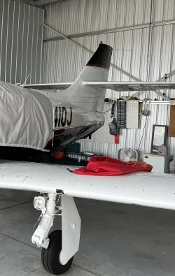

Hi Brent, I do not have before/after pics but saw a substantial reduction in elevator deflection in level flight. Picked up a true 4 knots as well. The fairings reduce drag as well. It’s a good mod to have.

Hi Bill, that’s a beautiful tail…you have a pretty unique Super Streamed Super Commander 112! I’m curious how bad your deflection was initially, and at what altitude do you see 4 ktas? I’m curious what typical cruise performance is for your unique bird in the 6-9k range?
