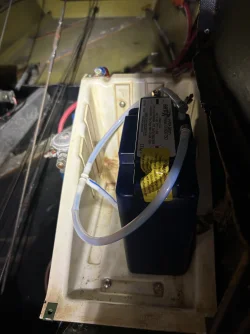

Yeah, the IA and I talked it over as to easiest method to comply with the instructions. So we decided to simply push into the existing drain as the teflon tube slid right in. Then I cut the C spacer down the middle to give a chanel for the tubing and some trimming on the ends for the side tubing. Simple enough. I don't know if my battery box was original or newer. The drain was centrally located, and the instructions showed it at one of the corners. the battery was touching the tubing, but not pressing on it with the spacer installed, so seemed fine.
To avoid kinks in the teflon tubing, I ended up buying some stainless 1/4" U-couplers, drilled a hole through the EarthX foam spacer, and was able to route the line down to the drain where I have it held into place with some silicone adhesive.
