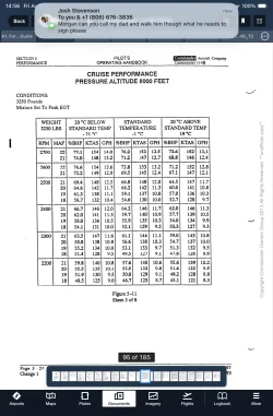

I can get close to these numbers with my stock 114B. Would I like to go faster? Sure nothing in life is free.

Andy, I had never looked at the performance charts for the B. In the A, we don't have TAS in the performance chart; that info is in another chart and derived from the power % we get from the MAP and RPM at altitude chart. I think I am going to take the 114A Charts and recreate them using the format used for the 114B; the info is much more concise and usable.
