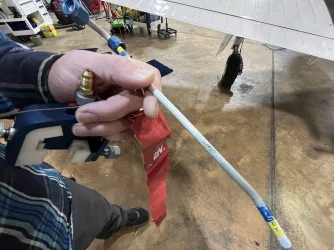

This is the line that leaked. The hydraulic line (8) had a brake line crossing and it obviously caused the eventual hole.
