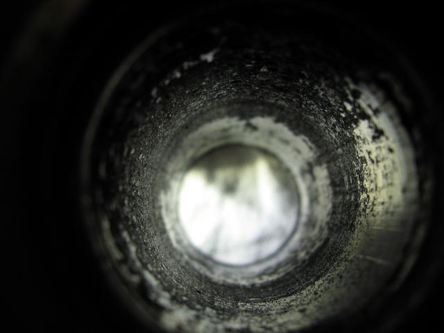

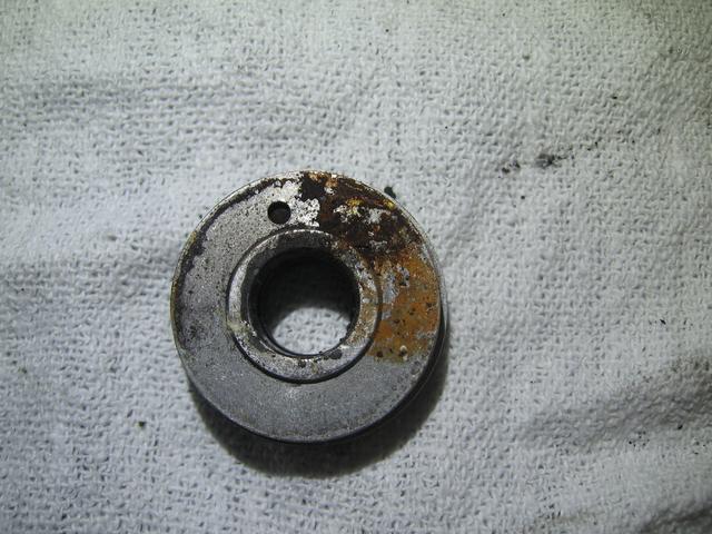

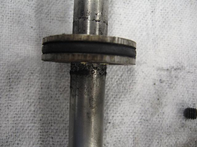

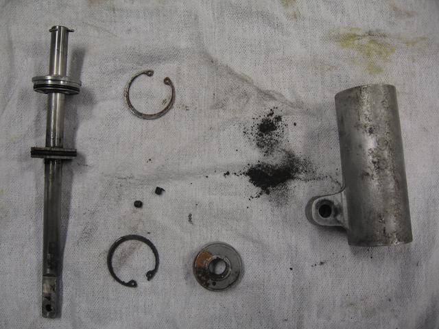

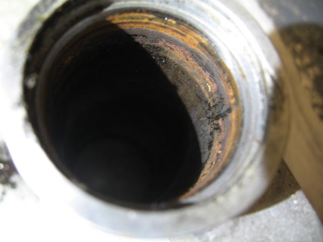

My shop thinks they're too worn to refurbish and recommend replacement.
See attached photos. (Btw - I tried using the VR image hoster on this forum, but it keeps rejecting my photos. Postimage.org allows you to resize them for bulletin board use. Hopefully they work)
https://s26.postimg.cc/i89oqoqg9/IMG_6354.jpg
https://s26.postimg.cc/8nq23slop/IMG_6356.jpg
https://s26.postimg.cc/fqxxjebop/IMG_6357.jpg
https://s26.postimg.cc/yj9smzfsp/IMG_6359.jpg
https://s26.postimg.cc/fqxxjeyu1/IMG_6363.jpg
Re: New Shimmy Dampners
Yes it does look pretty bad - looks like it was run dry for some time.
Another live and learn lesson as a new Commander Owner. When we did the pre-buy and the annual, this definitely slipped through the cracks. Since I don't know what a properly serviced shimmy dampener feels like on touchdown, I didn't think anything was wrong. I never got anything more than a wobble, and it felt similar to a PA-28 I had flown before this. My friends 182 felt the same.
I just assumed it was "normal" for a light GA aircraft. I certainly couldn't compare it to a 757/767 at work. I did talk to Jim Richards last month about another issue. When I asked about ordering some of his service kits, he said the nose wheel touchdown should be just as smooth as the jet. That's when I ordered the repair kit.
It was on my "to do" list and when the plane went in for a landing gear issue, I asked them to service the shimmy dampener. You can see what we found.
Trust me, this is now on my high priority MX list. Once again, this forum has proven invaluable for the depth of knowledge and expertise available. Many thanks!
