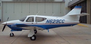

Hi Gareth; do you happen to be N629CC, S/N 544 in Malta? now w/a Hot Shot conversion?
that was a very nice 112B. :cool:

Spot on! Im impressed how you managed to identify which i am referring to!! Hehe
Yes thats the aircraft

your email was a good clue, Gareth. :D
does Kenneth still own it?
